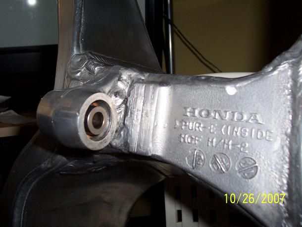

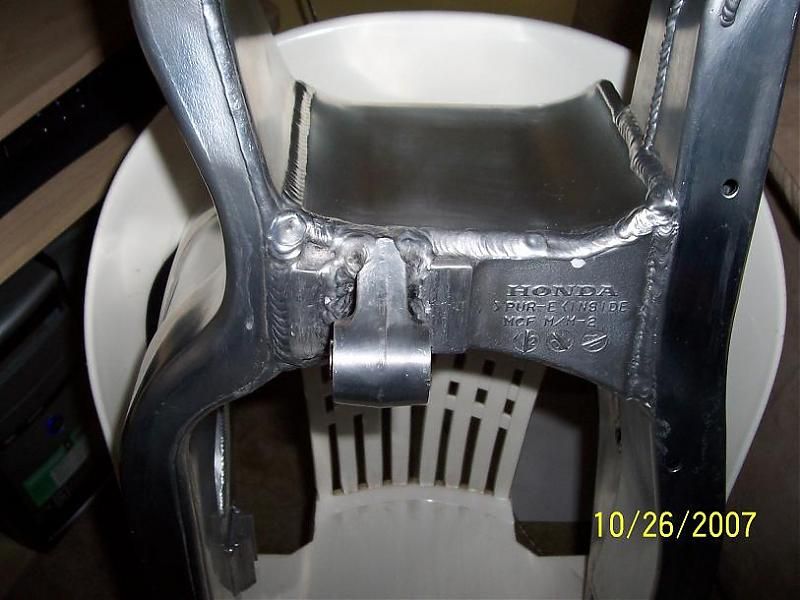

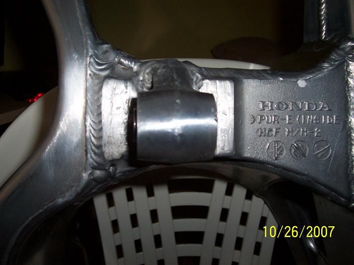

this is how i modded the rc51 swingarm.
the rc arm captures the linkage between two mounts
i cut the linkage and placed part of the linkage i had cut off.
once in place i welded it in.
then proceeded to cut off the original mounts.
