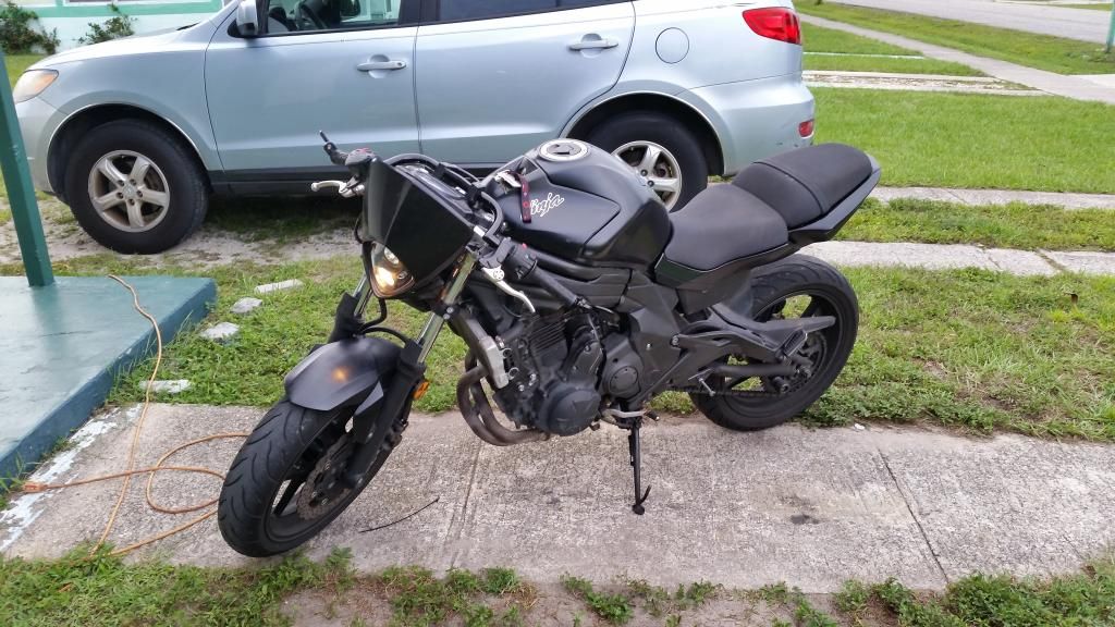

#19 ·
You did see this ER6N Streetfighter pic right? With dual headlights.
I'm pretty sure it mounts to the forks.
PM thesleeper and ask how it mounts up.
