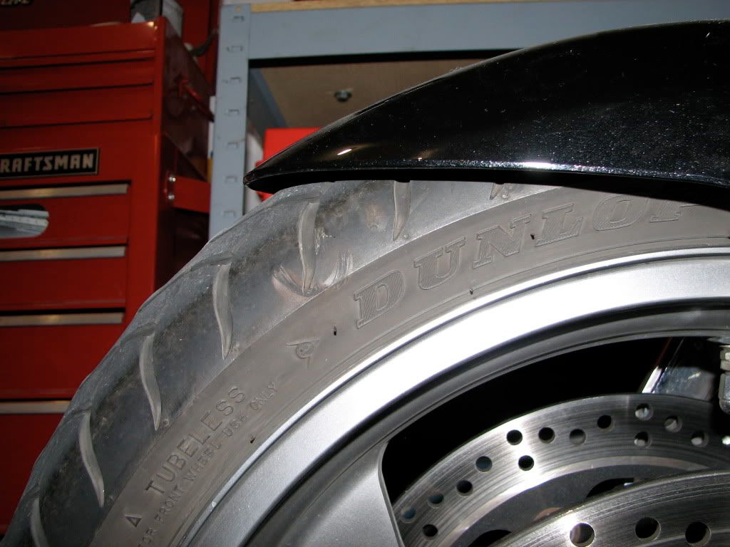

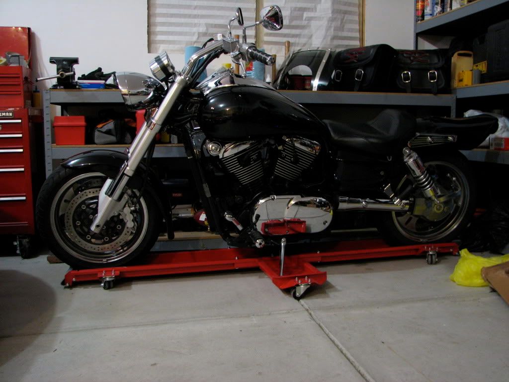

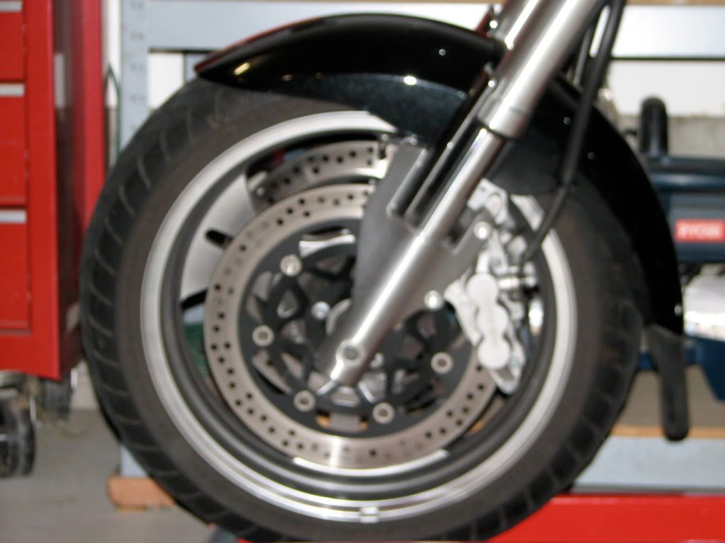

What do you guys think? I took a different approach. I used the reflector bracket hole in the rear, and then cut a short piece of aluminum to make an offset mount for each of the front mount holes, riveted them to the original mounting bracket before bolting them down. Hopefully the front isn't too low. There is still a good amount of flex in the fender, so if a small rock (very small rock) gets in there, I'm thinking it should spit it out. In case anybody is wondering about the mudflap, it was already on there when I bought the bike, and is screwed down, so I haven't removed it because then I would have holes in my fender.
Sorry for the crappy pics. It is late and dark and I am finally getting tired.

I have a gravel 300 foot driveway so I will just have to keep things stock, but I do like the look of the lowered fenders.

Really like the looks of it lowered like that.

Is it the taller than stock Dunlop tire? Not a bad idea actually. Since I followed your advice on the Yokohama S Drive 195/40/17 DS, I may do the same for the front. Good show again specialk!
Yep. I really put the 140/75 on there to counteract the wider rear tire, but "lower fender" effect is an added bonus.

so how did you lower your fender without removing it?

Just be careful with a lowered front fender. Not that I didn't lower mine again when I got a new one, but this was a very bad day!
