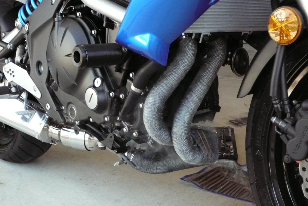

Thought Id post this up... excellent little kit, more than enough wrap and paint for a header, $60 and few hours time.

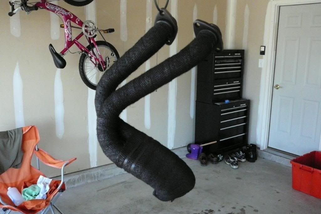

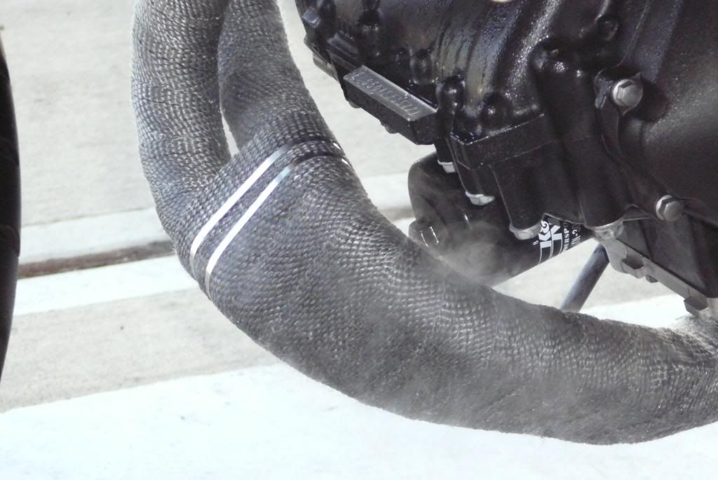

Drying the Header Wrap:
Still Drying:

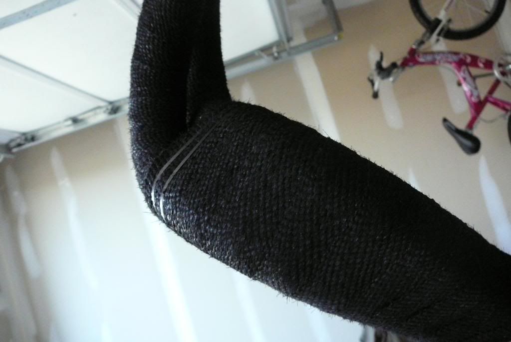

Painting:
Still Painting:

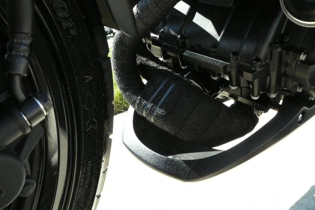

Installed:
Installed:
Installed:
Pretty easy to install, looks great, much less radiant heat!

That looks really good, nice work! I have been thinking about wrapping my header for some time. Where did you purchase the kit from?

Looks good. Does it make your headers catch more dirt and dead bugs? How would you clean it?

There is a specific direction you must wrap your pipes in order to catch less bugs/dirt, but it looks like this guy actually did it in the WRONG direction... Oops. (FYI: wrap back to front, not front to back) Still looks good though and will not affect 'performance' since so little of our exhaust system is parallel to the direction of travel.
As far as cleaning. It is usually not required, especially if you use silicone sealant like he did. This stuff bakes on pretty well and forms a good barrier.

The instructions actually say to start at the inlet to the header and work down, FWIW. Line 4 of the DEI instructions. DEI also has a YouTube video out detailing the installation process.

If you have a damp cloth, any bugs or mud splashes will come right off. With the silicone sealant on it, nothing soaks in.

I had always read to start from the bottom and work up, then I read step 4, and that said to start at the primary at the pipe port. Then where the primaries became to close, wrap them as one... so that is just what I did.:dance:
It did turn out stellar!
