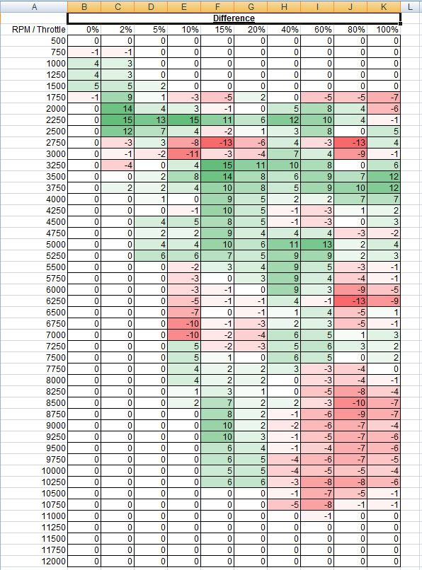

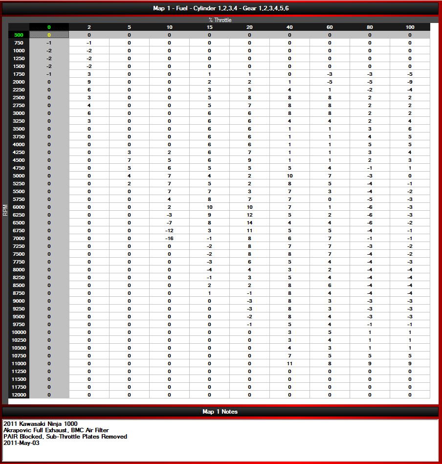

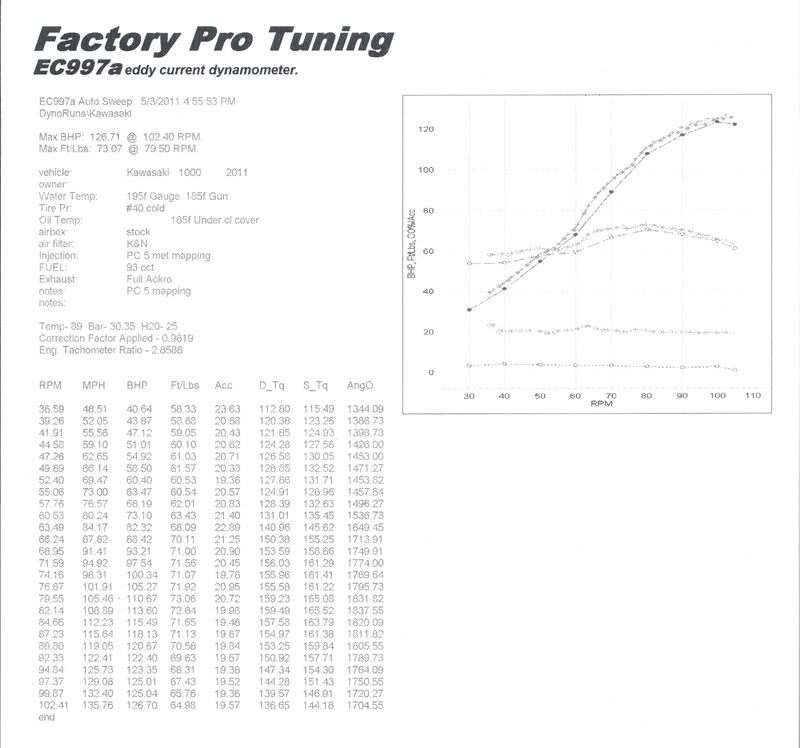

Attached to this post is the custom fuel map for my Ninja 1000. Some people were asking for this and I just wanted to make sure the tuner was OK with sharing it before doing so. This was done on a Factory Pro EC997A eddy current dyno in Houston, so sea level is about 40-50 feet.
The power mods that really matter:
Akrapovic Full Exhaust (Dual/4-2-2)
BMC Air Filter
PAIR Block Off Plates
Sub-Throttle Plates Removed
BELOW IS THE ACTUAL MAP FILE (ZIPPED)
>>> View attachment CLICK_ME_TO_DOWNLOAD.ZIP <<<
ALL THE USUAL EXCLUSIONS APPLY - USE AT YOUR OWN RISK
Here an actual screen shot of the map:
Here is a spread sheet that shows the difference between the map and the Dynojet Full Akrapovic map:
The dyno graph:

Here's a comparison of the stock vs the custom map.
As can be seen, the custom map is far from being just richer than stock. It's tuned for the intake and exhaust efficiency changes across the RPM range.
