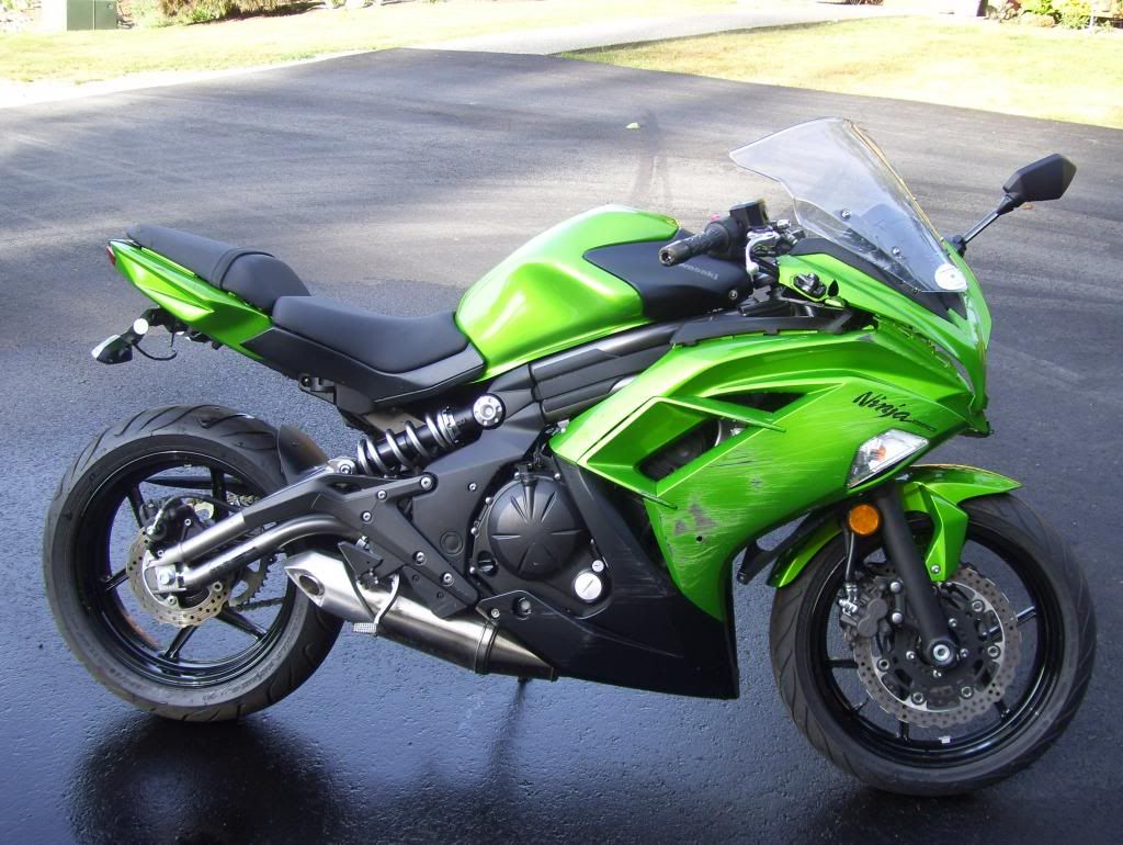

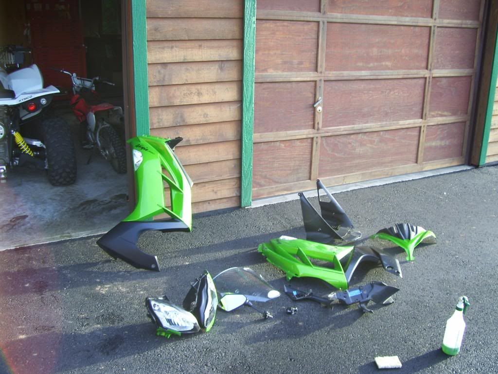

Started life as a wrecked 2012 Kawasaki Ninja 650 with 457 miles on it. Once the plastic was stripped off and a replacement headlight sourced from one of my other bikes, it was rideable, that is, with a pair of vicegrips in place of the missing right side footpeg.

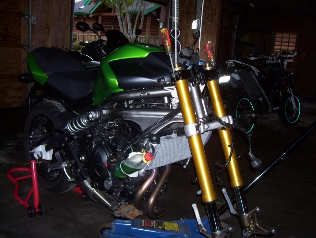

So, here is what was done to the bike. Removed the fairings, headlights, forks, triple clamps, front wheel, front fender, brakes, brake lines, bars, levers, perches, coolant reservoir, misc. brackets. With the rear of the bike on a swingarm stand, the front was hung from the garage rafters with winch cable looped around the steering head, so the entire front end could be stripped off, and it could hang for months, without worrying it would fall. It took around 3 months for me to source all the parts and get it back together. First came forks and triple clamps form a 2004 ZX6R, and if I had wanted to use clip ons, that part would have been done. I like superbike style bars, and riding position, so I needed a Z1000 top triple. First I tried a used (ebay) 2003-2004 Z1 top triple (2 pinch bolts per side). That would have worked, from what I could tell, but it was tweaked. I could get one side in, but the other side was at least a quarter inch off from being able to slide over the fork ( I knew the forks and ZX6 triples were straight as they slid right on with no binding as the forks were rotated in them). So I sent that back and got a brand new triple from my local dealer. First ordering an '04 Z1 triple, then hearing that would take much longer to get, ordered an '07-'08 Z1 (1 pinch bolt per side) top triple. Both Z1 top triples also required me to make a 5mm or so, collar to fit over the steering stem and fill the gap between the O.D. of the stem and the I.D. of the top triple, where they meet under the steering stem nut. With that sorted, and the triples and forks bolted to the front end, I sourced a 2005 ZX6R front wheel. The stock wheel could have been used, but the hub would have needed to been machined out from, if I remember correctly, 42mm to 47mm to accept the larger bearings needed for the ZX6R's front axle. And the machine work would have cost at least as much as it did for me to buy a used "straight" wheel, online. Then the stock Ninja 650 300mm rotors were put on the ZX6R wheel.

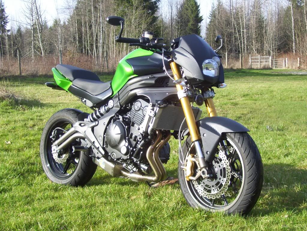

With the bike now on the ground, I got an '04 ZX6R front fender and wrapped it with 3M DiNoc carbon fiber vinyl film, as well as the headlight shrouds, and the trim piece above the taillight (none of them matched the Kawi candy green). The calipers were spaced out to accommodate the 20mm larger rotors, and custom Galfer stainless brake line were added.
On to the controls. A Renthal aluminum 7/8 bar was installed (I would have put on a fatbar, but I knew the instrument cluster would sit on top, covering it), with the bars installed, I had very little steering lock. To resolve this I cut down the vibration isolators in the top triple clamp to move the nut up higher that attaches the bars to the triple clamp, and also ground the top frame tube down a few mm to give me adequate steering lock, not as much as stock, but more than my Street Trip. So now the stud and nut that attach the bars to the triple clamp act as my steering stop, odd, but it works. Pazzo shorty levers for the ZX6R perches were next, so I could use the radial master cylinder (instead of the stock Ninja 650 unit, which I have heard will work), with a universal reservoir mounted to the brake lever perch. Then aluminum bar end mirrors. Also the coolant reservoir was relocated under the seat in a 10oz. liquor flask, for a clean right side view.
What to do for a headlight? I had been using the stock headlight from my '07 BMW G650XMOTO (Supermoto) zip-tied on, so I could ride it around before the teardown. I thought it matched the look of the bike pretty well, so I fabbed up some mounts and on it went. The stock instrument cluster was attached to the headlight bracket, angled toward the rider and set on top of the bar mount, for a functional and clean look. A pair of BMW turn signals were bolted to the triple clamp via a Suzuki DR-650 front turn signal bracket that I had laying around. Also the horn was relocated to the lower triple clamp.To go with the greatly improved front end, a Penske 8900E shock is being built for me as I write this, and should be a huge improvement over stock.

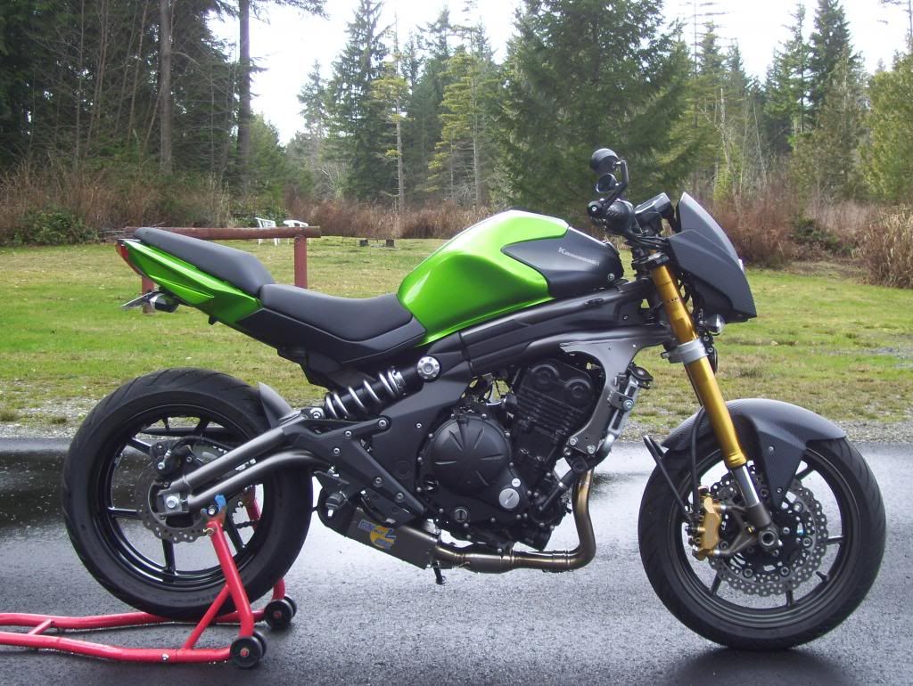

#12 ·
Updated pic with the new Penske shock, added 2 inches of ride height over stock, compliments the ZX6R front end very well. Much more compliant, no more getting bounced out of the seat.

Tell me please, Why do I see the Pre-load on your new Penske Cranked up so much? It looks like in the picture, your up to half the threads or about 40mm or so? I see you decided to raise the rear 2" to accommodate the front, Do you know where your new CG or Center of Gravity is now established?
Can you tell us why this is? Can't you just raise the forks to copy original rake and wheelbase? If you're a heavy dude, I can respect you're privacy.
Were you able to achieve your front and rear sag? Your Static and rider Sag?
At two inches higher, I would have to believe the geometry changed, did you compensate with more static sag and what about your "Squat" at the rear wheel?
Any gearing calculations to see about squatting and kick-up now that you have changed asymmetry of the powertrain from factory? The factory delivered the Bike in a nose up position when we purchased......... based on front and rear factory spring rates. Looking at the Rear Pre=load on that shock, you have the Tail up full and much much more than 4-9mm's of Pre-load on that spring.
Lastly, Some of the torque we produce (When we twist the Throttle, especially out of a turn) goes into wanting to "Flip" our motorcycles over!
This shifts more weight (or force) to the rear of the vehicle. On our motorcycles, this compresses the rear springs and extends the front springs as they each seek a new equilibrium position for the new loads. This is called Squat.
When were underpowered, the Drivetrain configuration, wheel and suspension components as the rear spring expands or extends is called Anti-Squat.
It looks as though you are in a full "Anti-Squat" mode to me my friend. Be safe. Be careful. and exercise caution.
