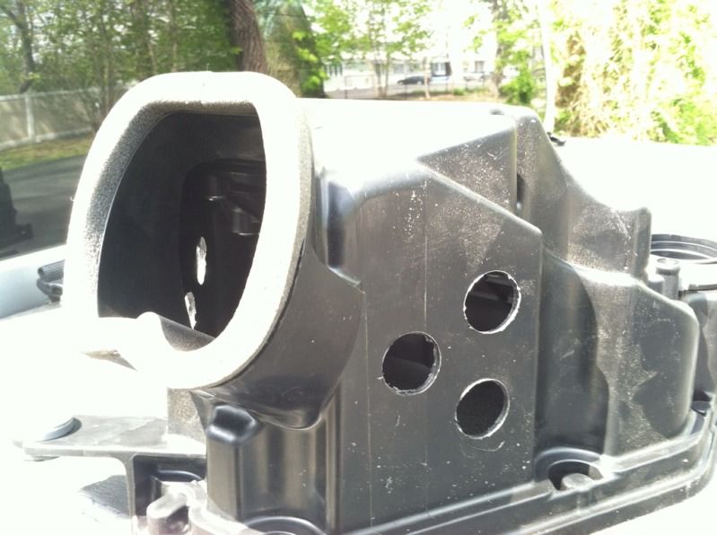

    Bring on the air!
    Pretty simple. Make sure you loosen BOTH sides of the airbox connected to the throttle bodies. It helps to remove fairing bolts to give fairings some movement.
    I'll see how it affects my fuel curve. So far I can feel a little boost but it is probably my wishful thinking!

    I did the same thing tonight to my z except i did 2 holes on each side. Then put a k&n in. Hoping to get some clear weather tomorrow to see how it runs .

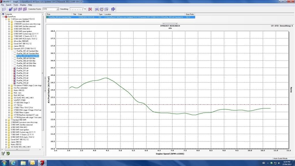

    Standard air filter, holes drilled, second flies removed = you will need a custom map to correct the A/F ratio.

    First time I've seen that afr graph. Is that the "stock" tune? What pipe? Tons of variables with that graph.
    I drilled the holes according to Ivan's tuning. I'm also running his map designed for the modified air box, full system, and removed sub throttle "butterflies."
    A stock bike is "stock." Dont start messing with anything until you have the ability to alter fuel. I would not modify an air box with stock tune - the bike is lean enough to begin with thanks to EPA regulations

    is this with stock exhaust? i guess im not that familiar with these graphs for the bikes cause is that considered too lean? its riding out 12.5 from 6k up, thats rich ? 13.5-14.5 in the lower rpm's doesnt seem that lean..ive seen dyno graphs with a pcv start out in the mid 14's in the lower rpm's?

    Quote Originally Posted by sweetlou View Post
    Lou
    Thanks for the advice Lou.
